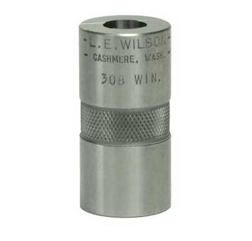

Planning to use the L.E. Wilson case gage for this. Like this one:
My question is, since the 30-06 and 270 are basically the same case, just necked down on the 270, and therefore should have the same distance between the base of the case and the datum on the shoulder, can I use the same Wilson Case Gage for both 30-06 and 270 Win?
Thanks in advance.

Thanks for the replies.
FWIW, I spoke to a tech at Sinclair / Brownell's who said I should be able to do both cartridges with the 30-06 Case Gage...fingers crossed...
I don't really care if the case body gets worked; what I'm trying to avoid is moving the shoulder back more than .002" or .003" from its fired dimension.
If you are able to drill a 3/8' diameter hole that is perpendicular you can make datums.
F. Guffey
Hornady uses the same dimension headspace comparator for both 30-06 and 270. Their inner diameter is 0.375" (3/8") for both calibers.
Thanks, guys. I'll report back if the 06 gage doesn't work for me.
Edit: Now I think about it, I can just adjust the FL sizing die in little by little until the bolt will just close on the fired and re-sized case (they're bolt actions -- M70 and M98) ... and then add some fraction of a turn to the die (calculated to add maybe .003") ... and then I don't need the case gage. Right? Is that what you're saying, Dusty?
One other thing -- some of these cases I want to size to the chamber were never fired in that chamber ... I have some old LC Match cases and range pickups and 1X stuff I bought here.
The simple answer to your simple question is "Yes". The SAAMI specs for body and shoulder are identical for the two cases. The case "headspace" max dimension, base to the .375" datum on the shoulder, are both 2.0562", and the shoulder angle 17.5 deg.
However, the 270 Win gauge should have a smaller hole for the neck, so it' possible you could have a case with a "false shoulder" (e.g. a 30-06 case only partially necked down to 270) which would not enter all the way home in a "270" gauge. In that sense, as pure case gauges they are not strictly interchangeable both ways. Happily, you have the one with the larger neck hole. ;-)

Assuming the case doesn’t need trimming so that the case mouth won’t be poked out the neck end of the Wilson case gauge, you can use the Wilson gauge body to get a case head to shoulder datum reference measurement the same as if you were using the proper Hornady or Sinclair insert in their gauge body. Just gotta be sure that the caliber registers on the case head, not on the Wilson’s high step, and get your reference number by measuring from the case head to the neck end of the Wilson gauge body.
