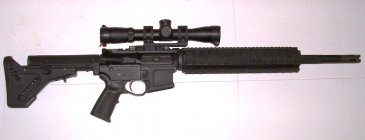

I have made it a personal project to develop this round (Widener 75gr.) I have tried IMR4064, H335, RE15, BLC-2, 748, and the best out of the lot so far is Varget: 1:8 Twist.
