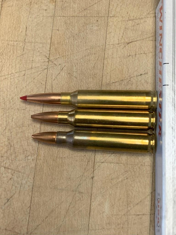

75 ELDm @ 2.5"
77 SMK @ 2.25"
55 gr FJM WWB
With the AR magazine, limited case capacity is traded for BC as the bullet weight is increased. From an AICS magazine, that tradeoff is removed if you're still free to specify the throat length. That effect is amplified with the 223 because the case and bullet diameters are relatively close.
While throating the chamber, I moved the 75 ELDm far enough forward to keep the rear of the bearing surface forward of the neck shoulder junction. Yea, that increases powder capacity even more but the larger benefit for little bullets at long distances is it tends to drive velocity spreads down. Particularly if the necks are not turned.
