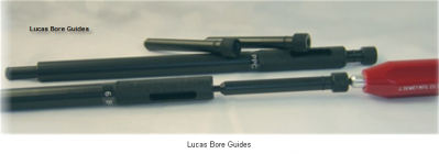

In my shop I prefer to use Lucas bore guides, AccuPro jags,with protective oring) and either Dewey coated rods or Tipton carbon fiber rods. This also precludes any metal contact or dirty product contact with the chamber, bore, or crown.
