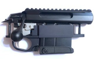

Went through great efforts to get the sendero stock barrel off this action. I now have the process down to a repeatable action but it's not easy. Curious about other's experiences.

Usually when you run into that kind of problem, you will find it was not so much a torque problem as much as a clean threads and lack of lubricant/treatment problem. Nothing to be done but just bust it loose and do it correctly on reassembly.
