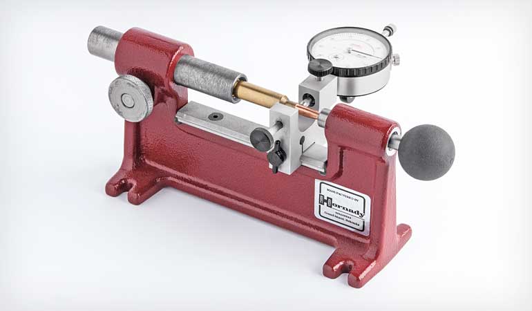

And what about loaded round runout? It's not uncommon for ammo to shoot well with .003 or more runout. That's 15x more error than what most would say a barrel NEEDS to be dialed in to be able to shoot well.

Found this article in Rifleshooter, and has interesting results, even if anecdotally.
He found that ammo with heavy bullet runout performed as well as those with mimimal to none- with an occasional flyer. Still, quite puzzling. If 80% of the time, non-concentric rounds shoot just as accurately- how does one explain the 20% that result in a flier?
I found the results of my tests conclusive but also perplexing. Clearly, sorting for tight concentricity helps eliminate fliers. According to these simple tests, it appears 80 percent of bullets exhibiting poor concentricity still group well, with only about one out of five actually resulting in a flier. But that’s enough for me to keep sorting my ammo for concentricity.
The above one would carry more weight with me if it had been conducted from a rigid rest instead of freehand off a bipod. Better yet, rigidly held test barrel to eliminate any possibility of shooter influence.
At the end of the day, it's likely another "it depends" variable with no definitive answer.
