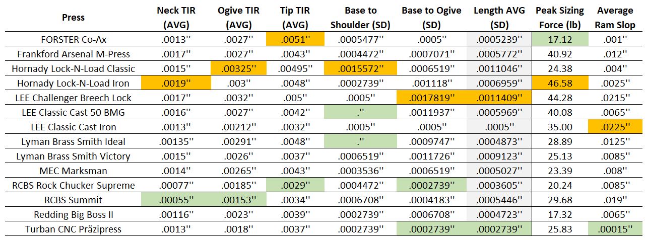

Fourteen Reloading Presses Compared: Single-Stage Shootout
https://ultimatereloader.com/2019/0...ng-presses-compared-single-stage-shootout/15/

Most reloading presses do seem to have some deflection and inconsistency in them. I measure after sizing each case for my LR BR rifles. That said, I know of two presses that have virtually no deflection. That is the Prazipress and the Zeropress.
I still get a little variation in shoulder set back with my Prazipress, but it is much less than with the Co-Ax and RCBS presses I have, and most likely caused by inconsistency in lubing the cases.
