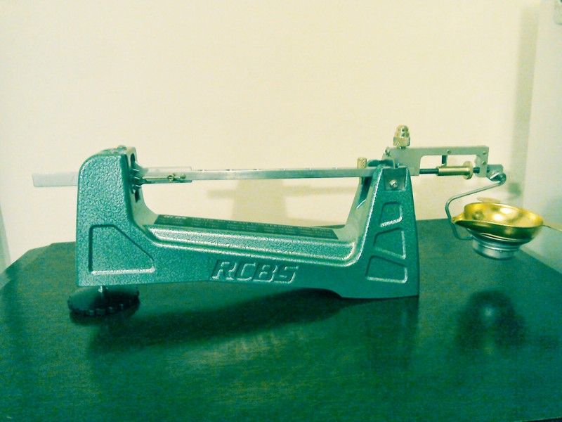

As you probably know RCBS has recently dumped it's existing range of scale, the 502,505 and the 10/10 and replaced them with two new scales, the M500 and the M1000 both have the beam printed on both sides and can be used both left and right handed.
sonofagun231 said:
Done, and my design still has many more improvements.
Are you going to let us have a peek at your design? Here's one of mine, a 0-65 grain beam on one of the new M500 scales. The extended damper plate gives an extra couple of inches of beam length when used with an auto trickler with a photo switch. Sorry about the poor quality of the pic.
