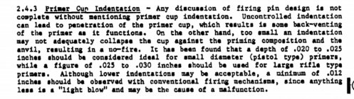

29.4 gr of Varget is max load in my Berger load manual. Your shooting 29.0. May be to much in your rifle? Back off .3-.6 gr and see if the problem goes away. I have several Rem 700 and I can see a raised area around the indent get more pronounced as I increase the load. You don't have raised area, proably because your bushed. My rifles are not bushed. The first thing you should do when you have a primer problem is to back off the load and see if it goes away. Don't keep shooting a load that may be to stiff. I see no hint of primer flattening. Looks like a deep FP indent?
Just guessing but the picture you have posted, the primer hit looks like it may be fairly deep?
Firing Pin protrusion? What should the Firing pin Protrusion be? De-cocked Bolt.
Could that ring be from the firing pin "bushing" imprinting on the case head that got slammed back on the bolt face from too much head space?
better not be. Hope the firing pin bushing is not at a different plane than the boltface...that would not be good. but that's not what it looks like.
https://discover.dtic.mil/ 20210319_105126.jpg
If the rounds head clearance allows the primer to back out .010" on firing, how does that equal a pierced primer?
The primer is stopped by the bolt face. With the primer against the bolt face and a set firing pin protrusion, the pin indent should be the same depth as zero head clearance?
If the primer backed out more on firing , there should be signs of gas leakage.
Does a bolt action firing pin remain in contact with the primer at firing? I think yes. So, to much pin protrusion will pierce primers?
High pressure may allow the primer cup to flow into the firing pin hole. The movement of metal has to come from some where. Metal flows up around the firing pin tip, thinning the cup. Pierced primer is from stretching of the cup metal.
I should have stated peirceing primers a complete hole through the primer several times I had to remove firepin and remove the little piece of brass from inside the bolt
Sounds to me like you are still getting cratering then. Or your FP tip profile is off.
You'll get a hole in the primer either from the primer being forced back against the extended firing pin to the point the pin is forced through (which should tear a hole) or from the primer flowing into the firing pin hole enough that the cup thins to its breaking point around the circumference of the flow (which will cause a slightly larger hole, and possibly leave the removed material inside the bolt.) If your firing pin tip profile has changed from radiused to squared off, that may act as a die and punch out a disk as well.
The firing pin hits the primer and the excessive head clearance allows the primer to move back over the firing pin and it acts like a cookie cutter and punches the center out of the primer. This is why military primers are crimped, it keeps the primer from moving to the rear.
