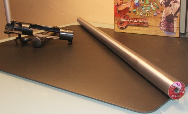

who wants to bet I cant get this old thing to shoot. 30br, updtd 7-22-10
First im new to this site my name is Scott, so thanks for having me, gotta go....
Just kidding
The business..... I gotta freind who has built a few of these in 6br and they shoot really well, and when I say really well I mean it shoots really well and its a blast to shoot.
Its a Japanese Arisaka 7.7 military action made in the Tokyo Koygo Arsenal prolly 1943-44 and the plans are to build cheap gun that I may decide to compete with later. In this thread I will document the idea and carry you through the entire build all the way til I get bored and put this girl in the safe and start something else.
The plan is to true the action, then chamber in 30br and thread the barrel you see below. Its a kreiger 18 twist in a light varmit contour and it will be finished at 24".
The rifle will be then bedded into a stock I get at Richards microfit. I will also put in a timney trigger.

I ordered my reamer from PT&G and it is going to be 0 freebore and a .330 neck size. I bought Lapua 6mm brass and will be doing all my sizing and seating with LE wilson dies. I also picked up some CCI br4 primers and H4198 powder.
Well heres the part where the really smart guys chime in and give up itty bitty pieces of great info and the nerds will throw up from theirs about how it will never shoot. I welcome all comments.

The main reason is that I have a freind who has built a bunch of these guns and he knows how to do all the smithing. I paid $125.00 for the action, and $138.00 for the reamer. A remington action would have cost a minimum of 300 bucks plus the reamer. This project was meant to be a budget build here are the totals far.
Action $125.00, Reamer $138.00, Barrel $295.00, Timney $67.00 Richards stock $155.00 Wilson Dies $135.00 total $915.00. So if it shoots .25 moa and I get to say I built it with the help of a freind its worth it to me.
Re: who wants to bet I cant get this old thing to shoot. 30br
And dot be fool by the action. The old Arisaka's are solid actions I happen to get really lucky my receiver is in excellent condition and the bolt i got from numrich looks practical brand new and and the bolt face doesnt have a mark on it, like its never been fired.
