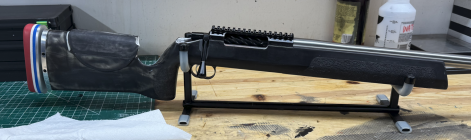

Interesting. I would have imagined both pieces flush with their respective part of the stock. On the cheek piece - are there through holes so you can adjust the fitment of the hardware?
Installing it the way they did eliminates having to machine an opening in the bottom of the check piece and keeps the integrity of the glass/carbon shell intact. Also on a side note. if you buy a stock from McMillan and it has an adjustable comb and a RAD recoil system installed by them, the above listed comb hardware will be installed upside down from the norm and the knob will be on the comb. I have a Kestros F-Class stock with the RAD II and thats how McMillan installs the comb to fit with the RAD system.
I like the KMW LoggerHead ACH Hardware better than what McMillan uses and its installs cleaner and the part that mounts to the comb you recess into the comb and the 2 guide pins can be adjusted so you can make side to side adjustments on the comb. This is the system MANNERS stocks uses. I have been using them for quite a few years and like them way better than the McMillan system. https://www.kmwlrs.com/loggerhead
KMW, makes the most rugged version, and McGee makes the most elegant adjustable version.

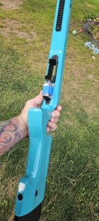

What did you end up doing, just taking the screws out and epoxy or use as pillars? Regardless, looks just like McSwirly did it. ;)
I torqued them down hard... and then used them like pillars. I feel like I have abused the designers intention, but it works for me. :)
