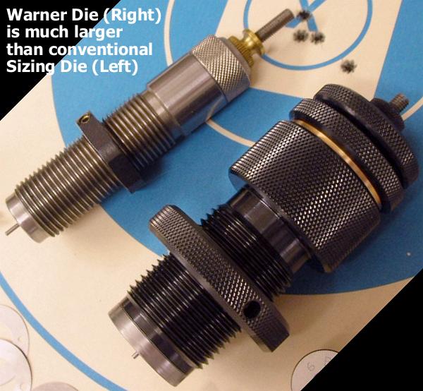

Here is the total newbies take on the WTC dies, I have only seen a friends, my WTC die has not been fabricated yet.
The WTC die is huge compared to the Whidden die which I bought first. The machining, feel and look of the die and parts are incredible. The tolerances are supposed to be within 0.0005. The neck bushing and inserts are huge polished pieces of finely machined steel. You do have to use shims for the head, but I guess this makes for a rock solid adjustment once dialed in, and you dont have to worry about it.
Like I said, Im a newbie and dont know crap about reloading yet, but comparing a WTC die to any other I have seen so far is definitely comparing apples to oranges. It makes the Whidden die look like a toy.
However, Im pretty sure all of the custom dies are capable of making good ammo. In my case Im just starting out and want to "buy once and cry once".

Can use any cylinder to "resize" a brass ctg case. Making something of quality and precision is something else.
No press threaded sizer is capable of the precision a press-seated die can deliver. Spending large sums don't guarantee results. Doesn't life all come down to compromises? Want speed and precision, you accept a bit of press slop and adjustment. Can use a Redding FL S bushing sizer in your Dillon machine and get over 100/hr; or go Wilson with an arbor press and go slower.
Does it matter? Maybe, if you got all the other variables sorted out and you are chasing the last .002 in group size that keeps you from the top 20 at a regional shoot... Are ya there yet?
It is funny how few show understanding of the variables but chase everything with money. A Lee Loader will do a lot in terms of precision, and their discontinued target loaders are highly esteemed; yet hobbyists assume if they didn't pay Big Money the stuff is no good.
If you want to control variables, and know why and what you want, a custom maker can do you some good. Redding S dies of Full Length design are about the most flexible sizing tools going. Remove the sizing stem and you have a body die. Use a spacer set and you have a neck sizer can vary size length w/o disturbing your FL dimension. Then, you got your FL function and all the bushing varieties. One die, of properly selected chambering, in .308 and .30-06 case families will serve all variants with same shoulder angle. Got a couple of AI cases in same family? One die will serve them too. Nice thing about the Redding S dies is their bushings will interchange with Wilson's; as both are 1/2" OD. Pretty easy to make your own if you have the precision tooling...
No chambering reamer is suitable for reaming a sizer die; unless you accept that your ammunition is not standard dimension.
Chamber reamer cuts to a greater diameter in case body, neck and shoulder to allow for case expansion and bullet release. Sizing dies are not made with reamers, too expensive. A boring bar setup to cut neck, shoulder and body is more capable and longer lasting.
Think about this... Chamber has to be larger than your case. If seeking precision, you cut your chamber to minimum specs. Still has to be larger than your case by .001" or more to allow expansion and bullet release. This is why Wilson and others request several fired cases when making a custom sizer. They're gonna give you a die with .002" or more sizing. A die made from your chamber reamer can't size at all; you're sizing comes from brass elasticity, not your sizer. At some point your brass is over size and your custom die can't do anything; not that it ever did...
