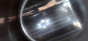

White/copper-ish streaks or scratches in new barrel.
Got a howa superlite 308. Was looking in the borescope before shooting for the first time and noticed these white or copper-ish marks on one of the rifling. Looks superficial and not really worried about it but just curious to see if anyone know what they are. Copper fouling from test shots maybe? I did clean the barrel thoroughly 1737827920598.jpg
I recently took my borescope to a gun store and scoped several barrels of new guns I was interested in. All of them had way more copper than I expected and one had a bit of rust as well.

How far down the bore? Did cleaning remove them, did they come back after shooting?
Did the break in procedure yesterday and the marks are gone. Probably just fouling, but whatever the case, they are gone. Was shooting pretty erratically at first but it started to settle a little after about the 12th round.
I always bore scope a new bore and then clean before I shoot. Most factory barrels I have seen lately have exhibited a shot down the bore. Especially the Howa rifles. The bore fouling seems to clean out easily with most having the copper streaks. I never shoot a new bore without cleaning it first!
Howa’s (barreled actions from Brownells) in my experience have been shipped with very dirty bores. My last in .223 was full of copper that took a bit to get out.

If this kind of stuff bothers you, especially since you have bought a borescope, what do you expect to see in the barrel? My advice it to pour a lap and polish the barrel. Most premium barrels, just the barrel, cost more than the Howa superlite. There is a reason for that.
I mean, you are firing a copper bullet down a steel barrel. Do you really think that that will affect accuracy more than it being just a lousy shot in the first place? Spend time learning the rifle and being a better shot. Things that matter.
First time having a borescope with a new rifle. Interesting to get a baseline. Streaks are gone after the barrel break in process.

DO NOT lap you own barrel. if you are looking for a quality bore, buy a quality barrel that has already been lapped by the manufacturer. More times than not you will screw your barrel up by trying to lap it yourself.

You should swab out the factory copper, oils, & rust before shooting a new rifle-
THEN bore scope it and see if you want to carry it back , and get your $$ back
