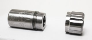

I have the FL Die and seater. Very vine. Great service. Make sure you order the case gauge. You will not know how you did without it. Makes setting shoulder setback very easy.
