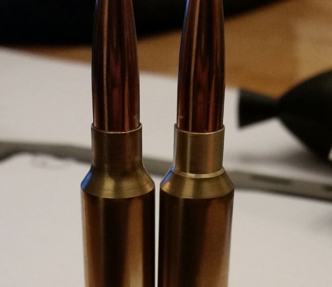

I got the Full Length Non-Bushing Click die sizer and seater set as well as the expander button set for 6BR. I was considering sending the non-bushing sizer back to swap out for a bushing sizer. I could then play with a bushing and button to really fine tune neck tension.
I am wondering if this is even worth it or just stick with my original non-bushing die and assorted buttons?
I know that many recommend bushing over expander, but Whidden gets better runout with his non-bushing with expander.
Runout being one aspect of brass prep, I was just thinking of the total control over neck tension without having to order a custom die like busumboa above.
