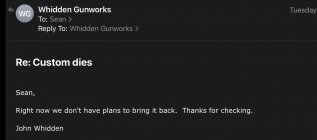

Over the years I’ve used Whidden for custom dies for some of the wildcats I’ve had built and shoot. I recently ran across a thread where someone mentioned Whidden wasn’t offering that service anymore so I went to their website, sure enough it is on their website that the service is suspended. I figured I’d send them an email and did, got an email back from John confirming that they will probably not be bring that service back. Bummer, it was a handy option.
So who offers custom dies now? In the thread where I read about Whidden a couple commented that Hornady offers custom dies with a 5-6 month turn around, sounds like they do a decent job. CH tool & Die were also mentioned. Most of the wildcats I do now days I try and get a custom die made from the builder, that’s what I did on my latest project but I would like to know of other options if they exist. Any input?

He emailed me back and I asked him to post here to clarify when he has a minute. I consider all his dies as custom so I'll let him define but sounds like he is still in the die business.
I look forward to seeing what he says. My understanding is they will still make standard dies, anything they list anyways. It’s just the custom dies, the one offs that may get cut but hopefully he makes it clear what their intentions are.
We will continue making our production dies just as we have been. Still made to fit to the reamers we're all using. We're even adding a few new calibers soon. We have no plans for these to go away.
What we're not going to be making going forward is custom dies, as in you send us fired brass or a reamer print and we make one set of dies for you.
For those who have ordered custom dies and are in our current production schedule, rest assured those dies will be made. We've been very busy and are a little behind on some of them but they're on the way.
