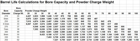

I'd say, all the above that's been mentioned effects barrel life as it all works in concert. To choose a single thing that's "most detrimental to barrel life" is apparently heat. And that's why I keep track of barrel temperature when firing and keeping my rate of fire reasonable.
Looking close at the chart below might help with an idea about that:
what is bore capacity charge weight? Say on 6mm...28? The others are estimated bbl life number of firings based on powder charge?
