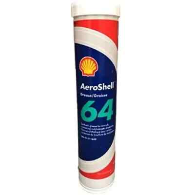

I use AeroShell 64 which is a milspec (mil-G-21164D) grease. I use it on every barrel threads before installing in my action (I dont put grease on shoulder I keep shoulder and action face clean) and I put it on AR upper receiver threads..
One tube will last you a lifetime. Ive been using it for 20yr and have barely used my tube. I keep it in a airtight Tupperware and just dip a brush in each time I need some.
This is the ticket. I'd buy it from an Aviation supplier. I bought it twice from Amazon and it came in those bubble/bag/envelope things, smashed, full of grease.
I ended up asking a mechanic at the local airport/FBO sell me a tube.
