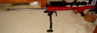

Checked my total rifle weight this morning
Eliseo B1 stock - fully assembled
Barnard P action with trigger
NF 12x42 BR scope (caps, knob covers, & battery removed)
Bartlein 308 1x12 32" med-palma barrel
Sinclair adj-elevation Bi-pod
[size=10pt]Total weight 17lb 8oz
Next F/TR season should be fun - any poor shooting scores will point to me (not unusual for me)
rinoray, thanks for checking and posting the weight info. I should be safe, my barrel will be heavier but action lighter so hopefully that evens things out to be about the same as yours.
