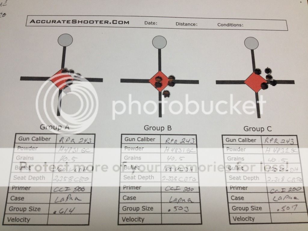

Berger 105 VLD Hunting. This is the second time I ran a seating depth test and it doesn't seem to care where it's at from touching the lands to a .040 jump. The first test was with 40.0 Gr of H4831SC. I bumped it up to 40.5 this time with pretty much the same results. I've always heard that VLDs were picking about seating depth and I've never had a bullet perform over such a broad range. I think I'll start with a .020 jump and work up .3 Grains at a time and see what shows up. The gun is a Ruger Precision Rifle in .243 Win.
Keep testing, and it may take a lot to find the best combination. Pick half a dozen likely powders and do a load work up on all of them. Pick the best one and then do seating depths tests again. You should be able to shoot below 1/2 MOA with the right powder/load/seating combination using most any decent factory gun if you find the right hand-load and make your ammo with care.
You might also consider using software like On Target for measuring your results. Remember, Mean Radius is considered by some to be more important than group size and On Target will perform this measurement without the tedium of hand calculating it.
Saying "about the same" to describe a testing session when you're searching for small differences in performance will keep you in the dark. Make precision measurements, track them in a spreadsheet, and keep experimenting if you want to shoot sub 1/2 MOA nearly all the time with your factory rifle. It's not difficult, but it does take a scientific approach.
"Just touching the lands" is a bad idea. With bullet run out, press run out, die run out, etc....., you may well be +002 to -.002. Now +/- two thou isn't a big deal when you are at .010 or .020, but when you are at 0.000 it is a huge deal as far a PSI is concerned.
I would forever skip the "just touching the lands " part of you load development and go strait to a .010 jam and a .010 jump!!!

Thanks for all of the input! Lot's of good perspective. My thoughts are in line with Homerange on working with Load B to see what develops. I have a feeling that it will find something that suits my needs.
Mozella, I hear you on the data tracking. I work with a bunch of Engineers that live and die by data and I know that's a weak spot for me at work and hobby.
4xforfun, point taken and I agree whole heartedly! I like your approach much better.
barefooter56, I don't have any chrony data for this load yet. I'll be getting some as I work up with the powder charges next weekend.
eric32, I haven't tried anything but 40.0 and 40.5 of H4831SC with this bullet yet. I have a load that uses 107 Matchkings and 41.7 of the same powder that shoots lights out while another load using a 105 Amax shoots under 1/2 moa with 43.5 Gr of the same H4831SC.
