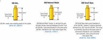

I see that Small Base sizing dies are available for 308 Win, but I was wondering what they do that a full length die doesn't? Does anyone have any dimension diagrams to show the difference between them? I'm considering picking up some bulk 308, but they come with the disclaimer that they may need to be small base sized.

The small based sizing die typically will give you an additional .001 of sizing over a standard sizing die.
diagrams above are good to know, but you need to know what your chamber requires etc.

I have never needed a SB die but they make them for a reason, if a std. die doesn't do it then the Small base is the next option.

AR chambers are usually slightly oversize providing a little 'slop' to aid in chambering a cartridge. Resizing dies will usually handle the slight oversize of the brass. But sometimes you will find a need for SB sizing dies. Yes, there will always be those who claim to be the exception but in general, the SB can be very helpful.
