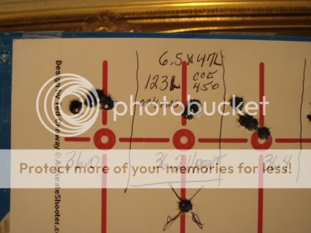

Been there, done that . . . then 123 Scenar's came in the picture for my 6.5x47
Middle target, my mistake on the bottom hole with the X mark. I have several targets that have the same groups using the 123 Scenars. Interestingly, the 120 smk's wll shoot the same group. Any bullet bigger, and FORGET it.
Just for kicks, here is the target using 120 smk's.
I agree with Dennis about the 120 SMK's. They are not sexy with a long boattail, super long nose, or some odd weight (117.83 grains would be a good one :P), but they have always been consistent out of any 6.5 I have put them in.
