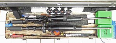

I'm trying at target AR :)
It's that 22 Nosler I post about.
The barrel is X-Caliber's bull profile.
Also put one together for the wife. Making it a couple's thing.
Only been to 600 so far.
