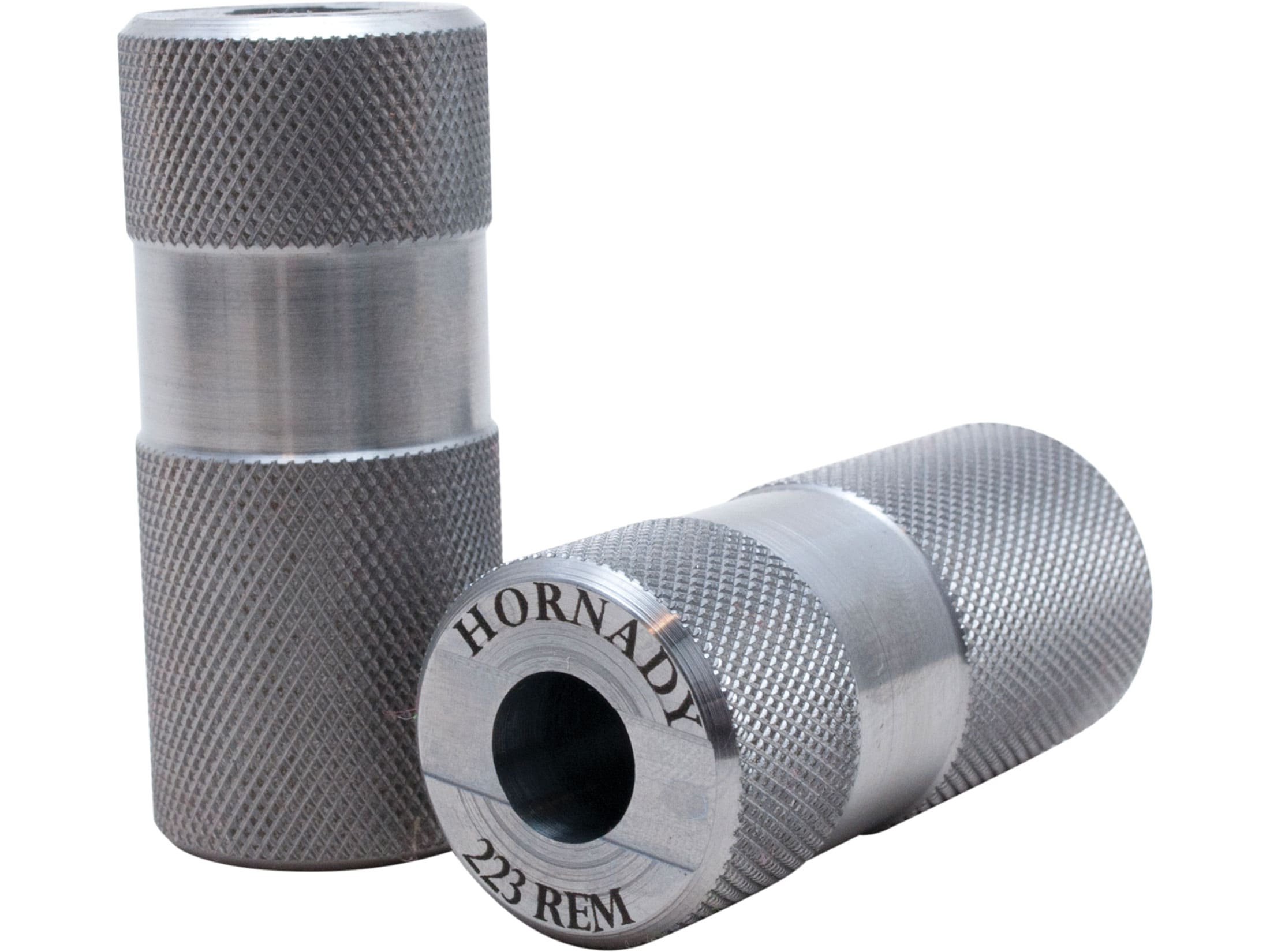

The Hornady says it is cut to the ammo MAX specs.

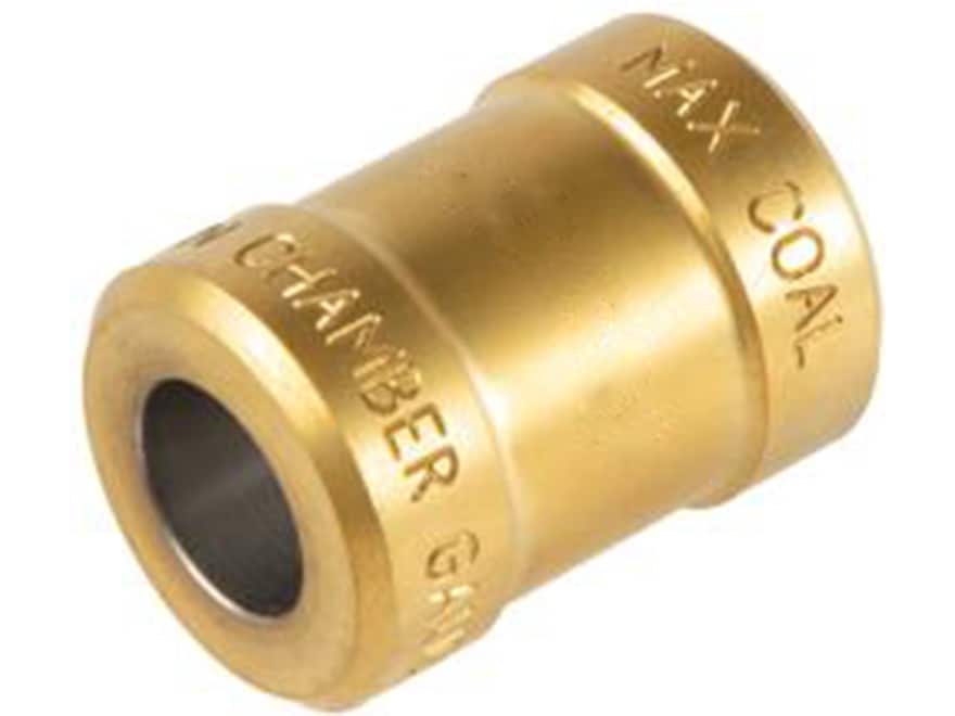

The RCBS isn't clear on if the gage is MIN Chamber but you can ask them.
The Lyman gage is cut to Chamber MIN.
These are not just marketing terms. The concepts of SAAMI/CIP Chamber Specifications versus Ammo Specifications are two different things, each with a set of MAX and MIN dimensions.
In your straightwall 38 Spcl example, there is a difference between the MIN chamber and the MAX ammo.

Sometimes, ammo that will fail the MAX Ammo gage, can still fit into the MIN Chamber gage. Pick the one that makes you happy, MAX ammo to be conservative. YMMV
The Lyman Multi-Cal Gauge is okay and handy but the, or most individual gauges will determine overall length, which is usually the length of the gauge.

I have had perfect success using the Lyman ammo checkers when the ammo needs to fit one or multiple chambers( both in handgun and rifle). I use it to check brass sizing as well as finished ammo. There is a 0.003 step.

I'd use a min gauge. If it fits that it should fit in any chamber. My match barrel in my pistols is what I use as a gauge. Only takes a few seconds to remove the barrel. I use Wilson gauges for mt rifle match ammo and their bump micrometer that goes with the gauge.
