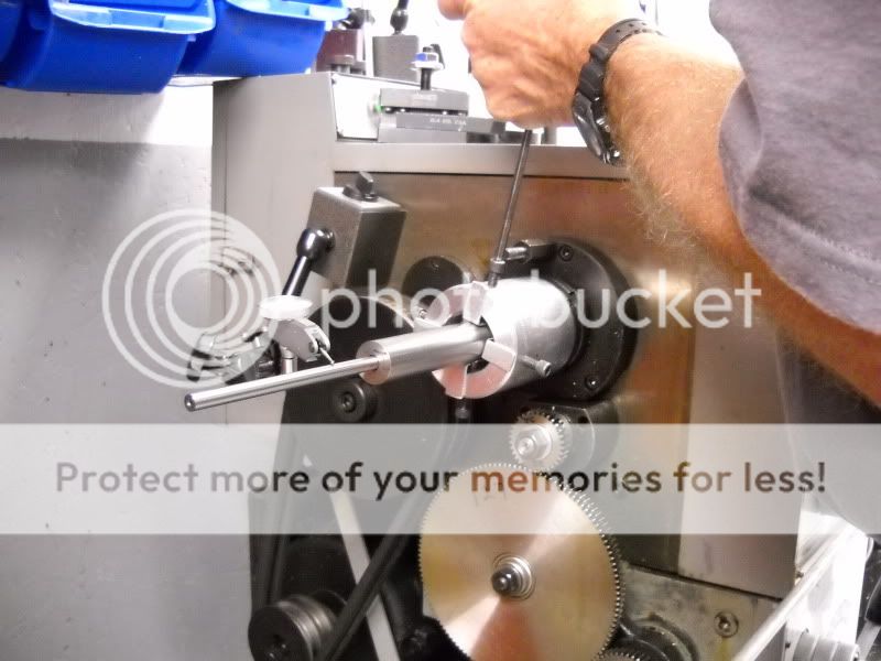

He drove on down, and then he watched me insert a Range rod in one end, and a indicator rod in the other end, and then dial in both ends to as little runout as I could get, then the long probe into the actual bore until that was running true.
The .004 was how much the outer diameter of the barrel was off from the center of the bore...
I pushed every thing fore-ward, and recut that nasty looking chamber, and sent him on his way with a nice shiny new chamber..
Thats what the thank you was for....
It sure beat waiting for Savage to reopen the doors in 2 weeks...
