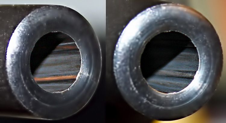

This is one reason barrels copper. This is one I worked on before and after cleaning. You can see the machining marks.
