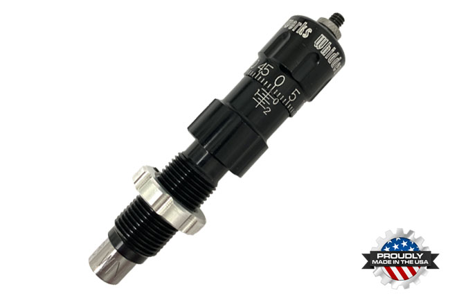

A BRDX Wilson inline seating die works great for me. Any BR based seating die, for a conventional press, may be hard to find at the regular online sites these days. If you haven’t reached out to them, give Whidden Gunworks a call. They would most likely be the quickest and they make great dies. You would also get a BRA specific die

If you happen to get the Whidden 6 Dasher Seater then look at their custom seating stems.
