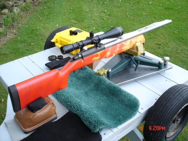

attachment.php
AI--rings are not blued--they are hard annodized.
just have to wait on email from speedy i guess.
Bill's rings should do fine as well
JB
