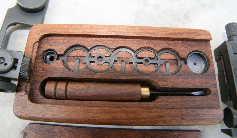

Doug Beach makes front sights like the top one. You will need to buy the iris with the circle in it too. Bottom one came on a rifle made by Michael Torre and I think he fabricated that one himself.
The bottom one in the picture is surplus to my needs at the moment. It has an 18 mm iris and a lens in it. Also the Redfield Palma rear sight is not in use. Has a Pic rail mount on the rear sight.

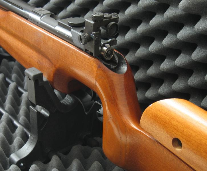

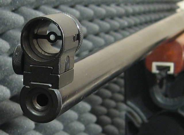

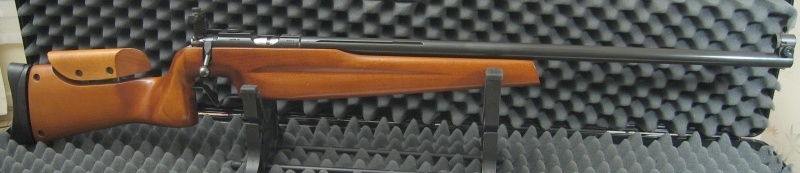

I've owned a BRNO md4 match with diopter and front sight.
The front sight seat on a removable part.
Removing this part and attaching sight directly on the barrel will lower 7mm, about 26MOA of elevation (Distance between sights: 840 mm.)
Diopter have about 49MOA of elevation (15 turns, 3.3moa/turn, 0.16moa/clic). It have an adjustable zero stop.
You may consider this kind of rifle for Long Range.
For eyes pleasure.
