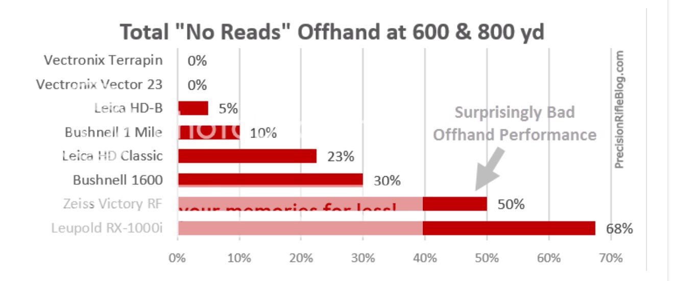

Here are some real world non biased reviews f the rangefinders.
http://precisionrifleblog.com/2013/12/03/rangefinder-binoculars-reviews-field-tests-overall-results-summary/

According to these tests your Swiss don't fair so well in some conditions such as off hand use.
After decades of shooting I still avidly read those scientific tests done by experts I don't know. However I call it the way I see it. We're talking 800 yards but most use will be 300 to 500 I would bet. Using off hand is for bow hunters. Trying to range far prairie dogs off hand is an exercise of frustration.
