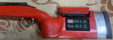

I came across a primed stock inletted for a 40-X and complete, in McMillan inventory, some time back.
I just taped off the butt plate and painted it red with decent spray paint, and it’s fine for small .22 matches.
It looks absolutely bland and cheap compared to pics of BC’s and others’ finishes, and pictures don’t show just how plain jane it is, with paint coming off corners, and all, and next time I won’t do it again, myself. It was also a messy process.
It’s functional though, if that’s the only goal. A .22 40-X requires hollowing out a space for the ejector’s retaining screw’s head, under the action.
A .22 LR doesn’t really move in the bag, so these patches don’t pose a problem in my set up.
