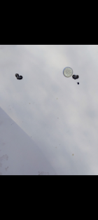

Shot this with V133 35g. Yesterday. Had ten shots and shot these two 4 shot groups. First shots for this barrel. 133 was all I had at the time. Yall were right about 30br being amazing. I just had turned a few cases the night before, and got it all ready. Never any of my 6br,or 6bra ever had the first shot groups to be that close. Iv had a over 15 barrels past few years with different cartridges.
The 30BR will reach out and grab you if you like the tiny groups.
