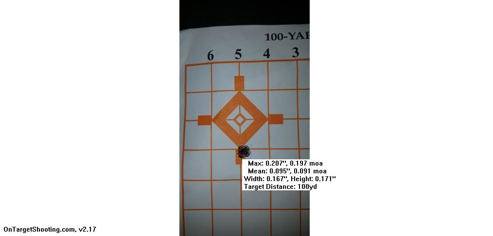

Anyone remember Rick Graham
10 shot WR
That’s a 5 Group 10 shot agg of .1990 Very nice!
I shot a .1797 5 Group 10 shot agg at Riverbend. Problem is the Range Officer forgot to turn the moving backer on for the first target. The Head of the measuring Committee told me he measured the targets and I indeed shattered the record, but he could not send it forward for measurementbecause they couldn’t count 10 shots in the moving backer of the first target.
Oh Well! I’d call that gun Accuurate!
Bart
Bart

Point-blank BR competitors may/must be both - especially in score (Hunter & VfS).
In IBS/NBRSA group shooting, precision is the only concern: a group anywhere inside the borders is good - most often, the group is centered deliberately away from ones aiming-point. Moving backers assure correct shot-count. After the first shot, accurate placement, relative to THAT shot, comes into play.
For IBS/NBRSA Hunter & VfS [score] shooting, a precision rifle is used to accurately place shots: the X-ring is 1/16Th inch diameter; the ten-ring 1/2". A single shot is fired at each record bull. Naturally, the target is proportionally expanded with range. Regrettably, the wind-drift, at 200 Yd., relative to the same increment, at 100 Yd., increases by a factor of 6!:eek: Per MPH of constant velocity & vector, at 1 MPH, that's about 0.060" at 100, and 0.36" at 200 Yd. - beyond 100 Yd., Xez are not exactly eazy. (Note: visualize how this also applies to shooting groups!;))
In point-blank BR, It is getting to where, a truly 1/4inch (almost MOA, but slightly better!:eek::D) rifle won't get you sympathy from even your best pals . . . since 1977, when I began shooting in registered BR events, precision requirements have changed. :DRG
