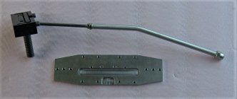

Alright then.....It's a bag rider for the CZ-At One. I need to do
some chamfering on the corners and should be good to go.
In the mean time, I'm also configuring a mix of parts to blend
Butch Lambert's Shade Tree top to a Bald Eagle rest. New top
plate is machined and extra long joy stick incorporated. Top
plate will accommodate up to a 6" Protektor bag. But for starts,
I'll have the grandson on a standard 2 inch bag for the original
stock. Have not made up my mind about a flat fore end as of yet.
Hopefully in about 2 weeks I can get the whole package together
and get him on a bench. So far it's been an 8 beer job with maybe
just a touch of Rye. I'll get pics on the bench soon......

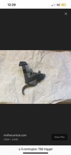

Without any context for size this is what I thought. Safety knob..

Fuj, what angle did you choose if you don't mind divulging a trade secret. :) I've made a few for my CZ VT from black delrin for testing and have made them at 15 degrees. I didn't research others at all, just took a guess and eyeballed what I thought looked like it would work. So far I like them. They're not permanent yet, and I'm using double sided tape to hold them on the stock while testing. Eventually I'll mount them with hardware of course, when I'm satisfied with the final design.
Generally all my bench gun's rear stock bottoms are flat and horizontal
to the bore. I have a Protekor DR flat top, rear bag that I'm fond of that
has a 1.125" width. I've been pattering off that. Just more added stability
along with wider fore ends.
