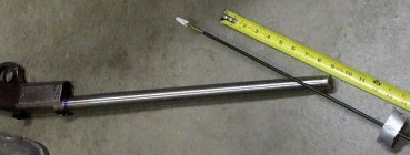

I checked 4 times in a row with tape on a cleaning rod.
Each time one revolution was exactly 14".
It is a 6mm PPC Shilen 21.5" Used SS Shilen 6PPC benchrest take off barrel. 5.1 pounds
$75 + $12 shipping = $87 off Ebay when the sold barrels
Have put it on Sav 99 and re chambered to 6mmBR
