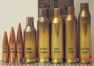

I just read at the front page about outstanding shooting with a 6-6,5x47. Now, how big a difference is there to this cartridge and the 6x47 Ruag, or the 6XC? If tolerances and throathing is done correctly, what can one do better than the other? At 700 yards, does theese tiny differences really matter? Would the shooter not be able to do this with a 6XC? And if he could, why bother with all theese wildcats? Every man his cartridge? Is that why?

Pan that pic may help.

6.5x47 brass is available and the best part...LAPUA...and is easily necked to 6mm...

To me that there is more to the differences between the 6XC and the Lapua 6.5x47,necked to 6mm).
As you say - The only brass available for the 6XC is Norma well same the same can be said for the 6.5x47 lapua. There is only one source.
Superior Shooting will have a 2nd source for the 6XC in near future that can't be said of the 6.5x47.
For all you case runout adherents- go measure a piece of the Lapua then a piece of the Norma and you will see there is no comparison.
There is no case preperation with the Norma 6XC brass,you will need to neck turn the 6.5x47 if you want less than .001" runout at the neck). The Norma is already .001" or less at the neck.
And if money is an issue the Norma is at least a dime cheaper for most.
The main difference,IMO) between the two is the small primer vs the large primer.
This difference can be argued till we all turn blue however the large primer was my pick for the case and I consulted a lot of knowledgable people in making the choice.

The RUAG and XC do indeed take large primers, whereas the 6.5x47 uses small primers and the small 1.5mm flashhole.
