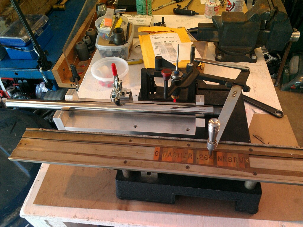

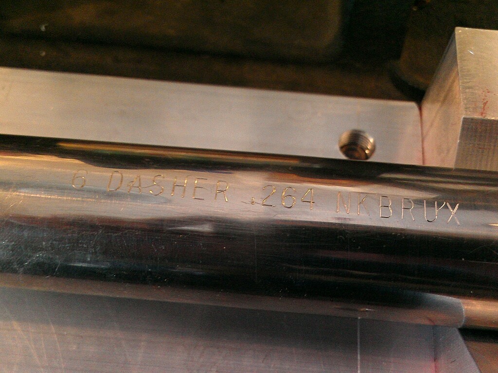

I have two pantagraphs one large and motorized and the second small and diamond Tipped.. If I were to do it over I would buy a CNC mill with the fourth axis. Stamps not done professionally look poor at best.
Nat Lambeth
Hand engrave on the bottom of the barrel. If you want it to show where other can see have it done by professional. Don't Stamp it. Larry

Any trophy shop should have a manual panagraph that could be used to engrave the barrel, either with a rotating carbide cutter or a diamond tipped tool as outlined in a prior post.

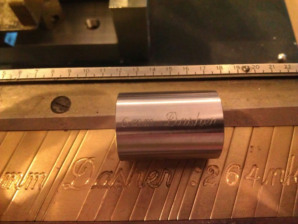

Start watching ebay or visit some trophy shops that have been around a long time and get a new hermes pantograph. Its what most gunsmiths use these days
I have a small New Hermes with a set of block font and Script. My ratio is not adjustable on mine, so I need the correct size font for 1/8"-1/4" high letters. I simply use a diamond drag. If doing it again, I would have a larger one with an adjustable ratio arm and a motor. CNC 4th axis is the ultimate, lol.

With all the computerized engraving these days, you should be able to pick up a used New Hermes at a good price. The adjustable ratio arm and the motor attachment are good options to have in addition to a lot of various fonts. When I owned my gun shop I think I made more money on engraving and selling trophies then I ever did on the guns.
