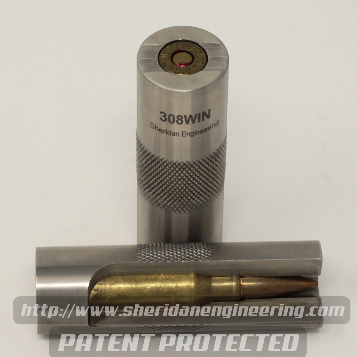

This brass is new once fired Starline, shot out of the box, I basically annealed and checked the cases in a Sheridan slotted case gage, expanded the necks loaded them and fired them from my Zastava M77PAP 308win, I shot about 100rnds and half of the brass came out with these cracks after they were fired, this is not from sizing,

What does the brass look like coming out of the chamber? What does the new out of the box/bag brass look like? That stuff looks pretty beat up for a single loading. Are you sizing the new brass before the first loading? Are you annealing the new stuff (I suspect it's annealed before leaving the factory), or annealing after the first firing? You're using the case gauge, but do you know that your chamber is a close match to the gauge?
