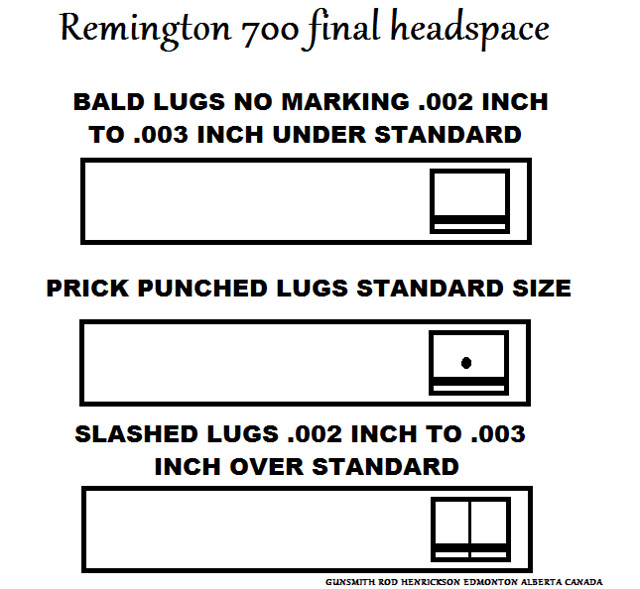

And farley recalled a run of actions due to bolt lugs shearing off of one so there is quite a lot of pressure involved. That is why every single remington action ever made has a hardness test done on a lug. Thats what the little dimple is
I'm pretty sure that little dimple is a headspace indicator so they could match up bolts to barrels so that headspace is correct. Seems like Butch Lambert forwarded that info from Remington if I remember correctly.
I thought thats what the serial number on the bolt did?
