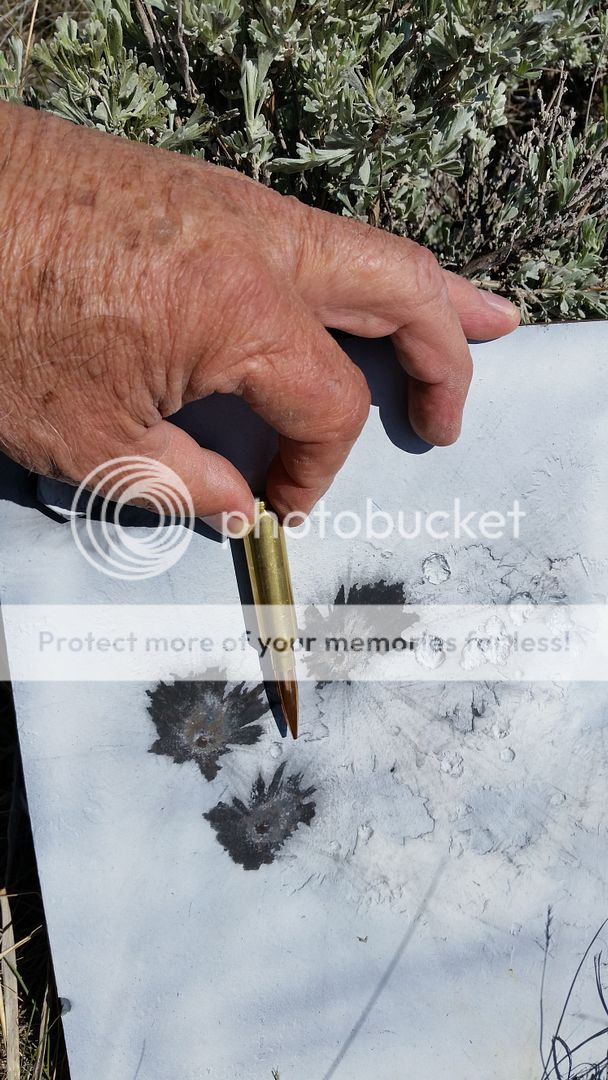

I only have 2 Coopers and they are a 222 Mag Model 21 Classic and a 6.5-284 Phoenix model 22. This is a picture of the first group I ever shot at 600. It was shot with the 6.5-284. I adjusted the trigger and that is all that has been done to the rifle.
