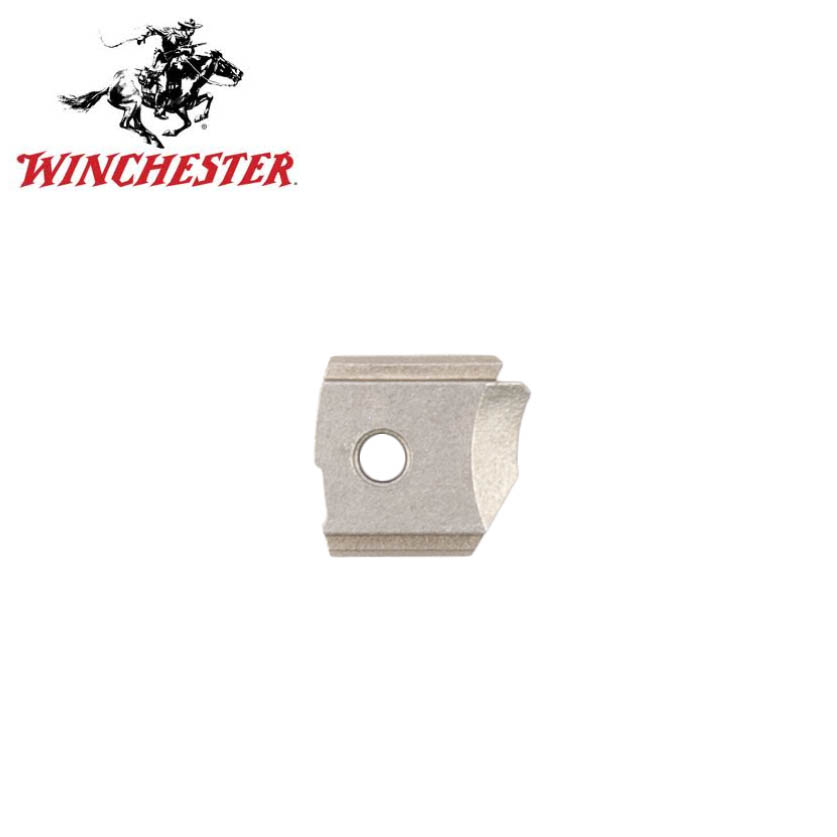

What extractor is this?
Sliding plate extractor. All sorts of flavors exist from the different manufacturers and few interchange. You'll probably have to go to whoever made it to get one.
Is it a Terminus Apollo or something else? All of the current Terminus actions have M-16 extractors.
Like bill bowers said looks like a winchester
