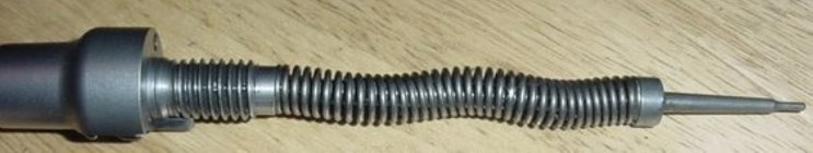

Still wondering which firing pin assy. is the preferred replacement for the J-lock. PTG, Gre-Tan, or maybe something else? Not sure how a picture would help with this one, but it looks a lot like this.

I put a gre-tan in mine with no issue.
