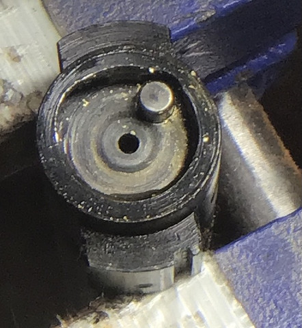

What causes this brass-stripping off case head?
Rem 700, factory barrel and bolt with no modifications (other than I replaced the extractor to see if that would help -- it didn't).
Cases fired a few times in this chamber come out a consistent dimension (measured after de-priming, but before sizing), and I set the shoulders back .0025 - -.003" short of that with the FL die.
Nearly every case has a swipe mark on its face (none on the side of the rim), though some do not show in the photo. Lots of little specs and flakes of brass around the ejector, and some find their way into the bore and come out on my cleaning patches - tiny flakes shining when I hold the light right.
I routinely remove the ejector and its spring and clean bits of brass out of the hole, but after a few firings the debris is right back there, all around the ejector.
It SEEMS to be that the ejector hole rim is what is scraping the brass off the face of the case. I don't know what else it could be. But the rim itself feels and looks perfect -- no high-spot or ding in it. The top of the ejector is smooth as can be.
I figure someone must have run into this before . TIA for any advice.

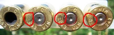

That first shot looks like the ejector hole does have an edge & that's what is marking a circle on some cases & other issues.
How would you be dropping the ejector out again and gently countersinking the hole the smallest amount with a brand new drill of suitable size or other sharp device?
I'd be good with that, and was thinking of it but did not want to try it before asking, in case I was missing something.

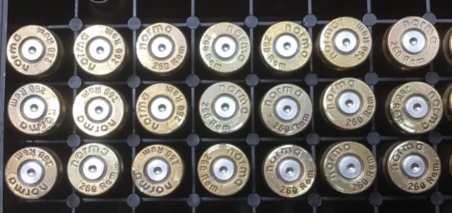

That brass says Norma on it, You cannot trust Norma ejector marks as a gospel.
However ejector marks are a high pressure sign so verify everything else carefully! Chronograph!!!!!!!!
I have had Norma 6xc brass with worse ejector marking at starting loads! Really tore my hair on that one.
The primers in the first view do not appear flattened or to be backing out and the firing pin dimples are crisp. This really does not appear to be a clear pressure issue, if the loads are working the path mentioned above to carefully debur the ejector and possibly take some steel wool to the ejector itself should be a fix. If it does not go away at that point you could bring the load down some and have better brass life as well.

Not pressure related. Chamfer the rim of the ejector hole a bit and your world will right itself.

The primers in your pictures didn't support the overpressure theory.
I don't understand the argument that ejector swipes are indicative of overpressure to begin with.
Extractor marks/gouging- absolutely. High pressure makes the case difficult to extract.
The ejector does nothing to the case until primary extraction has already occurred.
It is the naturally occurring motion of the ejector pin to swipe across the casehead as the brass clears the receiver cutout and can be pushed outward. I've got an AR in 6.5 that routinely needs brass shavings cleared from the boltface due to a very stiff ejector spring; I suppose I could disassemble the bolt, take a couple turns off the spring but I just don't consider it anything that needs to be "fixed".
Someone explain to me how swipe marks from an ejector are related to excessive pressure?
