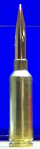

what bullet weight to use for fire forming the fat rat
MTSK said:
what weight bullet can i use to fire form my fat rat cases?
Don't know what a fat rat case is, but when I fire form my 6PPC and 30BR cases I use a cheap bullet [not my custom made bullets]. The cheaper they are, the less they usually weigh. I'm more concerned with powder weight than bullet weight. My first fire forming is usually conducted with about 2.0 grains less than my normal load. My second fire forming is conducted with my normal load. Hope that helps.
I'm guessing it's this variation on the 6mm RAT cartridge.
http://www.accurateandreliablerifle.com/products.html
why are you fire forming in two stages?
is it better to jump or to jam the bullets
