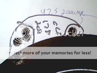

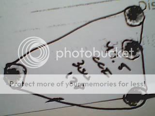

Has anyone had any experience with the Hornady 178 HPBT? This group was shot at 200yds, the flyer was maybe me, 47.5grs 2000MR. Bottom target was shot at 300yds(4 shots) 2.850" oal
