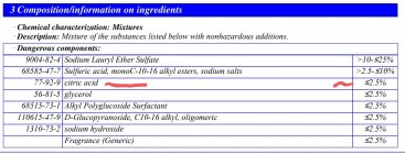

Too much Lemishine. Had mine do the same thing before I learned. Even gives the brass a totally different external texture. Almost rough feeling. Small batch of brass (<50) ⅛ teaspoon. Double it for large batch (>50) or really dirty.
Too much Lemi shine or/and too long tumble time. If your really bothered by it on this batch some time in a vibratory cleaner with walnut will probably bring the shine back…

As mentioned, it definitely sounds like your using too much Lemi Shine. I use very little of it when I wet tumble . . . like maybe a 1/4 teaspoon in my large Frankford Arsenal Platinum tumbler that's full of HOT water. And I only tumble for less than 30 minutes.
The Lemi Shine really doesn't do much of the cleaning. It's the Dawn with its very effective demulsifier that really does the work. And using very hot water adds to that.
So, if you're not already doing it, try starting with really hot water from the tap, a little bit of Dawn, and not much Lemi Shine. The tumble for ~ 30 minutes and see what you get. :D
