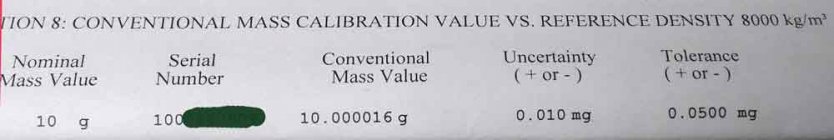

Not trying to defend the scale, or the 120i, as I have an A&D EJ-54D2 and a A&D ER-182A AND many very precise Check Standards (instead of Varget) to verify my weighing.
One problem I find with Varget is I get from 135 to 145 counts per granule on the 182A.
Get check weights near your target that are more accurate than your scale or desired results.

Use adequate check standards, You don't need the best, just better than what you need :)
And check your scale at several points near what you weigh.
