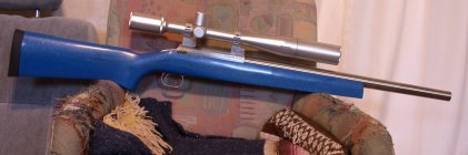

I do not know why but Weaver also discontinued the XR T-36 I have two of them and have had them nearly since they first came up for sale. I bought them because I have used Weaver T-36 scopes for many years, while my disabilities make side focus a game changer for me.
One of my XR T-36s is a silver one that I used with my BAT 222. It worked perfectly. Since I sold that rifle, the silver one has been back in it's box, waiting for my next Stainless action and barrel.
I see no reason the XR T-36 was discontinued and plan to never sell either of my two.
Here is my silver XR T-36 mounted to the BAT rifle:
