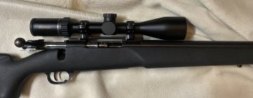

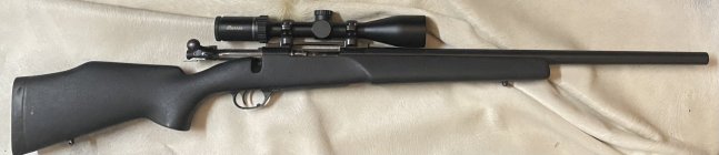

That makes sense to me based on it being small caliber, less than I might expect to be called a threat response rifle, but mine’s not fluted. That’s what the original retailer told me it was, though, TRR, but the name Weatherby gave it wasn’t a big factor to me. The heavy barrel was though.
Did yours look like this?
Back when I shot this gun, I had a Bousch & Lomb 4x16 large scope on it. I put a Near base on it after a couple of years, and I’m wondering what base I had before the Near, because I don’t think the larger scope would have cleared the barrel.
Dave, Stock on mine was a green cobweb design. Stainless barrel was heavily fluted. Marked ''Weatherby Super Varmint Master USA''. Barrel had a slimmer contour. SVMs show up on GB auction site now and then
