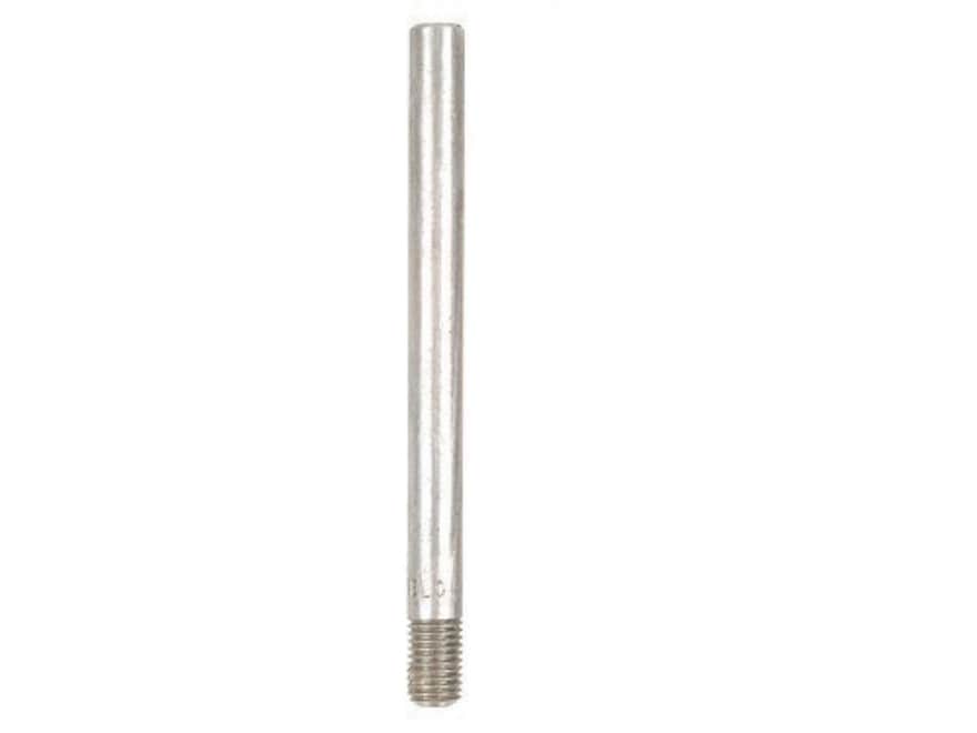

Where could I possibly find guide pins with the thread on the ends? Thanks!
From my earlier reply:
"The Vanguards and Howas use a 6mmx1.0 pitch thread. Get a couple long bolts with plenty of smooth shank length, cut the heads off and shorten the threads for your guide pins."
You'll have all of $1 in two guide pins. Forster also sells them:
